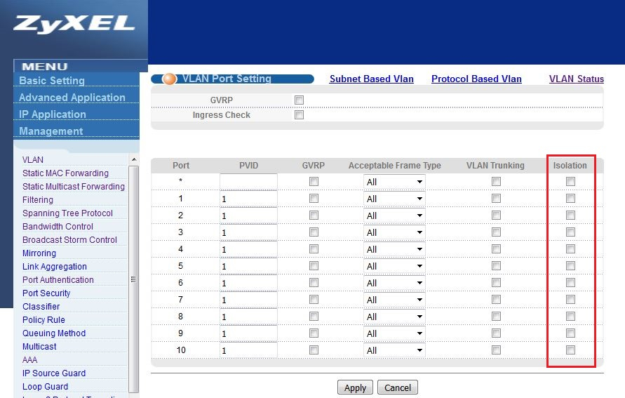

    Hi @djpiky,
    You may verify the followings on your GS2200 switch:
    1. Do you enable Port Isolation on the switch except for uplink port(the port which goes to the Internet)? You may go to "Advanced Application -> VLAN -> VLAN Port Setting" to check.
      If yes, you may disable it and try again.
    2. If there is an ACL configuration on the switch to block the traffic from the computer to other local computers?
    3. Make sure all your local computers have already disabled Windows firewall.
    Hope it helps.
