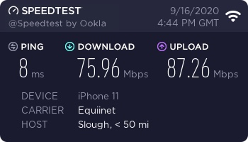

My iPhone connected wirelessly to the primary node (I placed my phone on top of the primary node!) achieves internet speeds of around 75Mbps.
My iPhone placed on top of either of my two secondary nodes achieves internet speeds of ~250Mbps.
How is possible that the wireless connection is better/faster at the secondary nodes when compared with the wireless connection at the primary?
Here are my speed test results;
Primary Node
Secondary Node

  • TimRTimR Posts: 3  Junior Member
    OK I have made some progress on this issue.
    The primary node is not reliably broadcasting on the 5GHz radio, so devices are connecting to 2.4GHz only hence the slower speeds.  This is true even when my device is physically on top of the node. Around the secondary nodes the 5GHz channel is being picked up fine and they see the higher speeds.
    If I reboot the primary node the 5GHz channel is available initially but at some point it drops out again.
    Is someone from Zyxel support able to comment please? Anything I can do to resolve this issue?
    Thanks!
