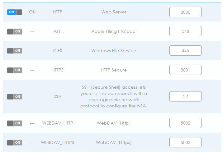

Moreover, when I was making sure that this feature is allowed in the mycloud.zyxel.com settings, whenever I trigger some settings and revisit it, it appears as if to be turned off. If I toggle it, is says that the changes were successfull on the next page, but if I come back to the UPnP settings, all the toggles (except for http) are shown as off.
I tried reinstalling the app (my zyxel cloud agent), even reinstalling the firmware (v5.21 abag3), but the only change was that initially all the toggles reverted to off, and after the reinstall, all but http revert to the off position. Also, sometimes the port numbers change automatically and even if I confirm the change with a different port number, I can still access the NAS on LAN over WebDAV through the original port 5003.

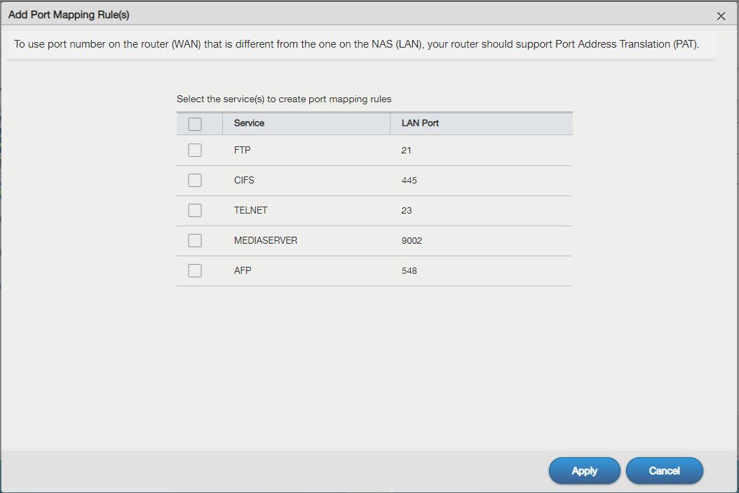

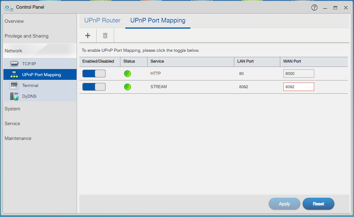

I wanted to set the port forwarding on the NAS itself (Control Panel, Network, UPnP Port Mapping) to be sure the router isn't the culprit, but I cannot see the option to do so (I can't even see the http/https protocols).
Moreover, the mapping conditions change without my intevention, on their own. At first, there was a WEBDAV condition set for ports 5003, later a STREAM condition appeared, and now WEBDAV disappeared and was substituted by HTTP (however, I can still access the drives mounted with RaiDrive via the port 5003). I have no idea what's happening here, if I toggle the mapping off or change the WAN port (eg. of the STREAM), it doesn't stick - I just confirm a dialog, it's loading for a while and then it displays the same things as there were before.

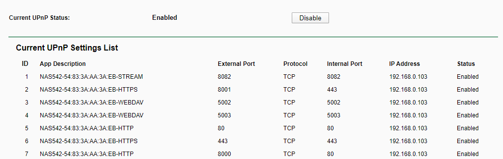

Also, the UPnP settings really got copied to the router settings, even though the webinterface doesn't show it:

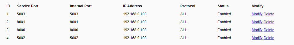

    Port forwarding rules are screenshot above - 5003 <-> 5003, 443 <-> 443 etc.
