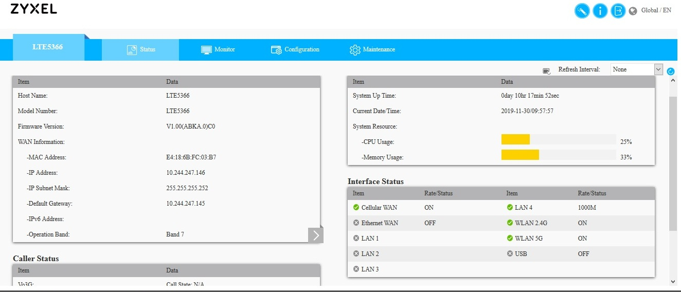

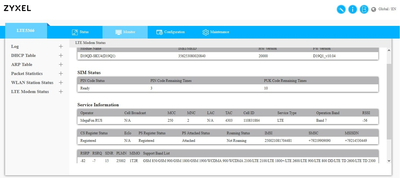

Internet disappears when downloading at high speed. what could be the matter ? Thus loading increases to 23-27% and does not disappear. Also in logs there are error messages httpd: process_method_get:1883: Written error. Are there any updates for this device ? Was the LTE5366 tested at a speed greater than 100 mbps. at first glance, something is plugging in the services in the device itself. logs attached.

    Always, as soon as the load increases at high speed, after 5-30 minutes the Internet disappears. However the Web interface works, it is possible to walk on pages of a configuration, to look a log. But the Internet is gone. It helps to restart the device from the menu or turn on the power supply. The error "httpd: process_method_get:1883: Written error" occurs just at this time when the Internet goes missing.
