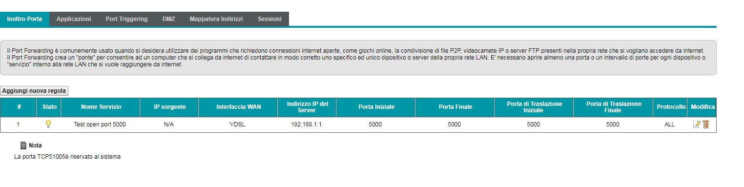

Now I opened too port 5000 on my netgear for access to  hd by ftp and I wanted to open port 5000 into my zyxel to access it from outside my house. I can't open it also if I tried to set port forwarding or port triggering.
I can do this only if I add my netgear with address 192.168.1.254 into DMZ.
I don't want this but I want to open only one port to access to hd.

  • NeAlNeAl Posts: 29  Junior Member
    Hi Genius19,
    if you go to Network setting / NAT / Port forwarding / Add new rule or Edit existing rule, you should find the "Server IP Address" field.
    Set it up with the Netgear ip address.
    For example, my setup is like this:
    Internet --- Zyxel --- (raspberry pi + usb hdd)
    The raspberry pi runs a ssh/sftp server; remote access works fine.
    Zyxel model VMG8823-B50B, provided by Wind/Infostrada.
  • Genius19Genius19 Posts: 13  Junior Member
    @NeAl Have I to set in this way or I have to insert my router zyxel in "IP server address"?Have I to insert "IP sorgente"? Regards
    Hi Genius19,
    I have both "Configurare IP Originario" unchecked and "IP sorgente" blank.
    Also, keep in mind that I'm using sftp.
    If you have to use ftp, as Mijzelf pointed out, check whether you need to forward a whole range of ports.
