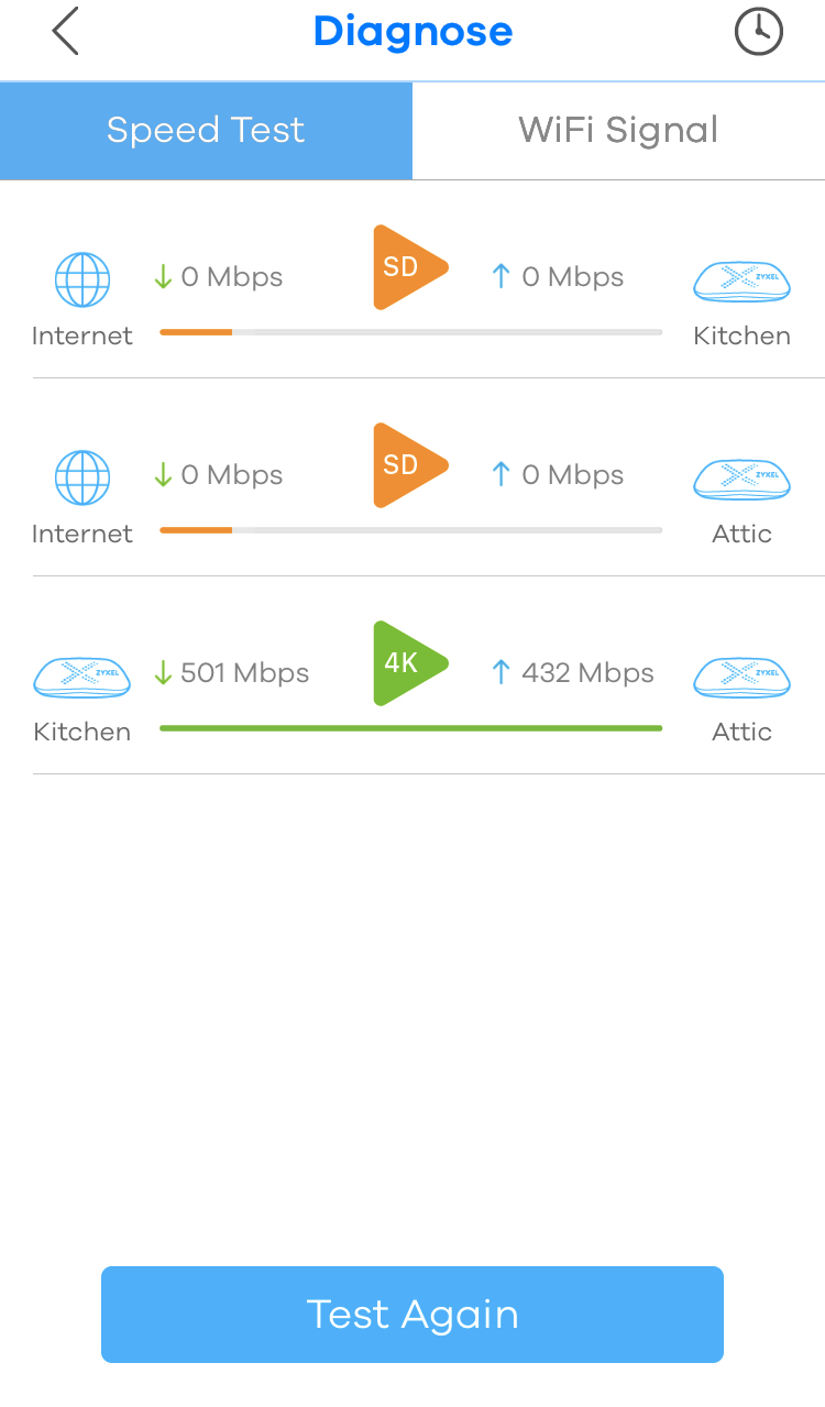

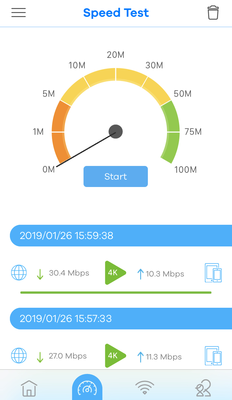

when running the diagnostics speed test it is showing a 0mb to both my 2 multys. Although using The speed test to my device using the  app shows I have a good speed.
WiFi backhaul / connection between the 2 multy is fine.
Is is there anything I can do to rectify. I’ve tried resetting.

    Recently, Ookla (Speedtest) server has changed its protocol from http to https to cause Multy X cannot get server list. We are working to modify the configuration file of Speedtest and will release new firmware to fix this issue soon.
    Update.
    New firmware and new App has released to fix this issue.
Answers

  • SouthernOllySouthernOlly Posts: 2  Junior Member
    Thanks. Upgraded to the 1 Feb firmware and all sorted.
